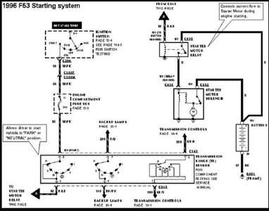

Here is a discussion on another form. Many of the questions revolve around safety switches, particularly the Neutral safety switch.

Some Ford wiring info
