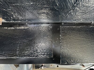

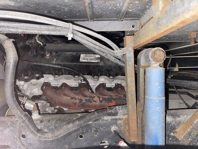

As far as heat goes, I can assume you are talking heat from the engine. I had head on the passenger floor. What was happening the hot air from the engine does not go straight back, but to the side and on motorhomes they don’t build wheel wells. So i made a panel between the engine and wheel area. That stopped the heat in the floor area.
Here are pictures of the engine exposed then after I put the panel in.
