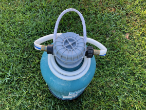

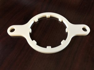

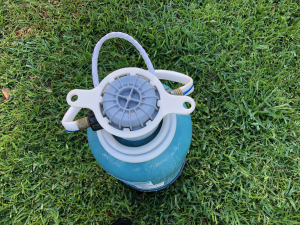

I was at a CG recently and @ARD couldn't get her water softener cap off. I have large channel locks (pliers) that we used but I was in fear of damaging the plastic cap. A neighbor happened to be aware of various accessories by On The Go Portable Water Softeners and one of which is a cap wrench. Works like a charm. It's cheap on their web site, add shipping and it can get a little more pricey but I figured I haven't done my 3D printing hobby in a while so why don't I whip up a design and print my own. Voila:

EDIT: I forgot, we put food grade o-ring lubricant I had on the o-ring under the cap and that solves the problem of the cap sticking. This is also good for your dump/gate valves when the time comes they need to be lubricated.
