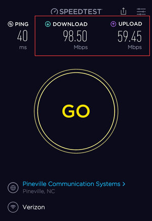

Last night I connected the Parsec Husky's to both of my Pepwave MAX Transit CAT 18 routers to test the antennas before I did anything on the roof. The test would not really be a good comparison as the antennas are inside sitting on the dash. The tests showed very good results on both AT&T and Verizon that I use. So today's work proceeded as follows.

Did I say pain in the butt? Never doing this again but it's done. So far performance is good but it's too soon to really compare and I don't think I can compare antennas as cellular speeds change by the minute. I'd say if I did this over again I'd either go with the Husky or the Pepwave all in one that's out now (421 I think it is) but I like having the antennas on the AC shroud as it's an ideal location in my opinion for 360 unobstructed view.
