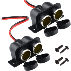

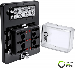

Having recently (when in AZ last winter) made a nice wiring modification by bringing a 12V fuse box to the passenger side in the bay forward of the pegboard adding 12V runs is easy. I'm sure I have a post on the forum somewhere but it was easy to add a 12V 40A self resetting breaker behind the cord reel wired into the side of the 12V relay controlled by the salesman switch, then use a heavy gauge wire (8 I think it was, or 10) to then run to a 6 way blade fuse box for 12V connections. Today I added 2 x 12V sockets, one forward of the pegboard bay that I'll use with the Green Mountain Grills Davy Crockett to avoid the need for the converter from 120V to 12V as the grill is 12V powered, and one in the Dometic cooler bay to give it the 12V fallback. Simple mod just requiring the wire runs to the 6 way fuse box.
