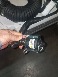

This project had been on the to-do list far too long and I had all the parts in hand (well, most of them), so today was the day. Easy job! In addition to putting fittings on the hose connected to the Sani-Con unit, I also fitted out a spare hose with Banjo fittings as well. What I wasn't able to do...yet...was to put the Banjo fittings between the pump and the connected hose. I need to order one additional set of fittings for that. My math skills failed me when I ordered fittings. :rolleyes:
For this project, I used the Banjo 150 series Polypropylene Cam and Groove fittings with hose shank ends...
Banjo 150E Polypropylene Cam & Groove Fitting, 1-1/2" Male Adapter x Hose Shank: Plumbing Hoses: Amazon.com: Industrial & Scientific
Banjo 150C Polypropylene Cam & Groove Fitting, 1-1/2" Female Coupler x Hose Shank: Camlock Hose Fittings: Amazon.com: Industrial & Scientific
...and, some 1.5" ID black silicone radiator hose...
Stainless steel radiator hose clamps were on hand in my shop. I shortened the hose shank on the male fitting on the Sani-Con sewer connector end to reduce the overall length a bit. This made getting that fitting down through the sewer hose port in the floor of the wet bay.
Here are a couple of photos:

Isn't the whole premise of the Sanicon system not having to remove the hose and keep the waste contained? I can see using a coupling to add another hose for length, but see no purpose in disconnecting it from the pump.
Nov 2, 2019
3,405
WA, MT or somewhere else!
2018
Mountain Aire 4047
40'
2014 Honda CR-V
I installed the quick-connects to (1) facilitate easily adding an extension when I needed extra length and (2) to make it easy to change out a hose that goes bad and starts to leak. I am not envisioning disconnecting/connecting the main hose on a regular basis.
That said, you raise a valid point as it applies to the need for quick-couplers at the Sani-Con pump itself. I need to revisit that idea. If the hose at the pump comes off as easily as it did on the other end of the main hose, it may be just as easy to simply carry a spare hose with a quick-connect on just one end. Something to think about.

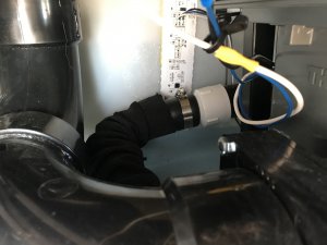

@TJ&LadyDi I have slightly different install of the Sanicon than you do as my hose pump connects at the back. I have the extra hose and will add the banjo connectors to enable quick addition but not at the pump. I did change it out when I got the hose with protective cover and wasn’t that difficult.
I think the convenience of adding the additional hose with banjo connectors is a great addition

I did mine with Banjo disconnects in the wet bay for versatility. In my place in northern AZ i have a sewer hook up next to my wet bay that uses the same banjo connectors so I hook up and I can leave the grey open and I only dump the black as needed and I have no hoses laying on the ground. I stay there 5 months through the summer. The other thing I found was it is a lot less cluttered in my bay by removing the bulk of the hose when its not needed and it can be stored out of the way. I think its all personal preference but I can tell you you have zero contact with the waist water when you connect disconnect and cap the system.

I replaced the original hose with the 30’ hose from SaniCon. The Banjo fittings make it easier to store the longer hose by removing the end. Also, the original hose with Banjo fittings serves as an extension.

Now, @Neal, you will be faced with deciding whether to put the female couplers on the inboard or outboard end. Conventional plumbing wisdom is that liquid should flow from male to female fittings, but I didn't do it that way. My thought process is that the outboard end of the hose is the most likely to get dinged up from being dropped, etc. The female fitting has the protection of the outer housing around it to keep that from happening. If the male end gets dinged, it may not seal properly.
It will be interesting to see what you decide.
