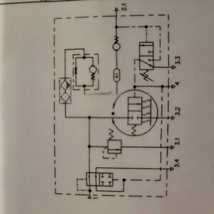

Ok. I did a bit more research. While the air dryer does have an electrical connection (making me think that the purge may be controlled electronically), I've learned that this electrical connection is for the heater built into the air dryer.
I'm thinking that the only time there should be air in the dryer when the engine is turned off, is if the compressor was filling the tanks when the engine was turned off. That may explain why I've only heard the purging noise every so often. So if that is the case, is the dryer designed to purge that air or would it just stay in the air dryer until the engine is started again (or the air leaks out of the air dryer)?
