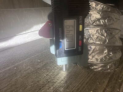

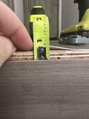

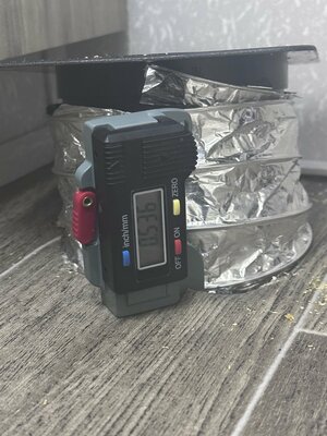

I've attached a mil tool that measures considerably more accurately than my tape measurer. Their are two images. One is the floor thickness with the laminate on top, the second is the thickness of the laminate by itself. The entire thing is 0.56 inches, the floor is 0.049 inches thick, this means the actual size of the floor is 0.49 inches, which would be in line with 1/2 in thick plywood. I have tons of it at my house, and when I measure it, it's between 0.48 inches, and 0.51 inches, so I'm confident this is just half inch thick plywood. I guess my question is, is this normal to market something and then you get this. Surely the variation in sizes isn't THIS much?I was just giving you the standard sizes, all of which are smaller than nominal.
Also, it appears to me that your tape measure may not actually be at the bottom of the plywood, but it's hard to tell for sure from the photo.
