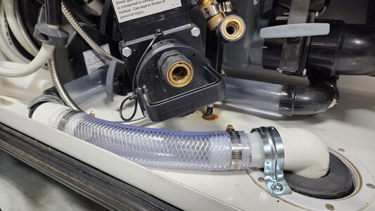

Well another Sanicon hose failure less than a year. Replaced 2/2021 purchasing from Newmar parts and failed 2/2022 and replaced under parts warranty. Failures were located close to the end where it connects to the pump discharge so last year I decided to add PVC to remove the bend thinking it would relief the strain. You can see from the picture it didn’t help. So here I go again removing the protective cover and putting it on the new hose hoping this one lasts more than a year.
