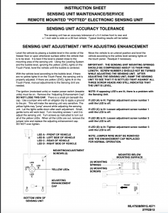

Ok, we are newbies (2 weeks old into the RV lifestyle), so please forgive the rookie questions and mistakes! We have a 2020 45’ London Aire coach. We tried to use the auto leveling system last night at the RV park. The front went up so high the front tires we being lifted.? Is this normal? Thanks for any advice or answers you can share.
