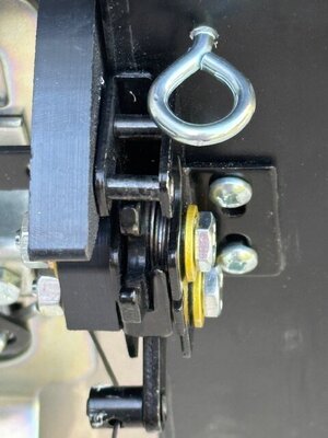

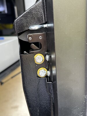

On our way home from the Keys the front baggage on the drivers side opened.
What is the best way you sure they stayed latched?
We both checked it prior to departure. It was locked tight.
The entire trip was on relatively smooth roads, typical US roads.
I had once adjusted the wires attached to the handles because I thought there was too much slack. About a mile after I left the campground I found that the one of those compartment doors had opened. The lesson learned was to keep a sufficient amount of slack so that the doors don't accidentally open. I have since also installed a smart switch that notifies me when the basement light comes on (ie door opened) when I'm driving.
Our lift up entertainment bay door used to come loose while traveling.
Mothership adjusted the catch so it is tighter now and can’t vibrate to unlatched. Luckily it is heavy enough that it never swung up before we had it adjusted.
