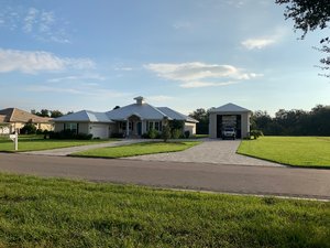

@Akdare … I sent you a PM. I have something similar. Barn with workshop in back.

@TJ&LadyDi - the inside of the garage is 50' x 20' and that works just fine. However, if I had it to do over again, I would make the width 22' just to give me a little more walking around room when the slides are out. The garage door is 14' x 14' and that is the minimum size I would go with.
