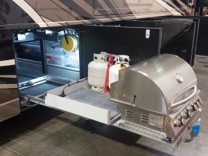

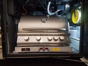

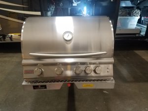

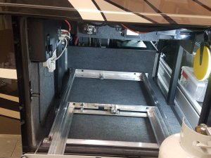

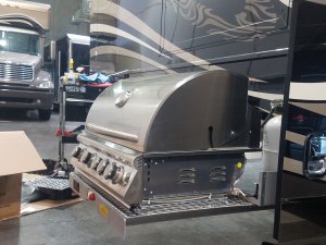

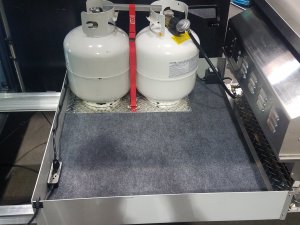

Finished up the bbq project
32in Blaze 4 burner ss grill
custom slide tray that extends 125% of its length
slide will support 200 lbs on the end fully extended

Very nice! Any concerns with the propane being internal? As some barked about this in the past I'm more careful only to put the tank inside during travel, otherwise it stays outside the coach.
have gas and co detectors in bays and living area. Have used this set up for years no problem. I don’t travel with it valves in the open position. DOT Regs allow up to 20lb tanks to be in an enclosed area With out restrictions or placards. We carry multiple 20 lb tanks in our box vans for running heaters inside of buildings with no issues For several years now. I make sure it’s properly tied down, obey dot road rules use common sense.

That's poetry Dave! Where did you get the custom slide tray?
Slide Master. They will build any thing you want
