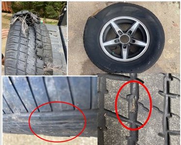

We bought our brand new 2020 Coachmen by Forest river in Dec 2019. We have about 3000 miles on it. Last week our first tire blew out and took out my whole inner wheel well with it. I changed out on the hiway and made it home on my spare. Upon getting home I checked the remaining tires and found that the other 3 had steel belts showing, bulging and twisted threads meaning they too were about to blow. All tires were made in same month with the same DOT number. I contacted my dealer they said contact the tire manufacturer. I did, lions gate sent me a form with a bunch of conditions and told me they would not replace the tires until all the conditions were met. I completed the form and conditions (pics, vin, description etc) a few days ago and still waiting for them to contact me back. Best they will likely offer is a new set of garbage tires. Mean while I contacted my dealer about the damage and they said that they were not responsible because I'm beyond my year warranty and that they could not look at it till Dec. I contacted Forest river and they said contact the tire company. I asked them for the parts to replace and they told me they would not help me out. I'm at a loss. This Forest river customer service is garbage and so is any warranty they apply. Its buyer beware. If you have these castle rock tires ST 205 75R 14, DOT JUJT 1119 change them immediately! If anyone has any advice on how to get the dealer or Forest river to fix this let me know.
