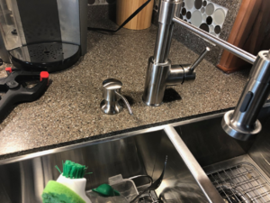

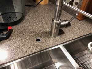

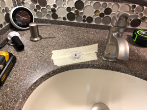

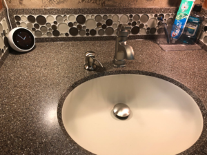

Recently I took a big risk and drilled a hole in my corian counters and added soap dispensers to my kitchen counter and my master bath sink. Tips are to use masking tape (study youtube videos first) to avoid splintering, drill a small pilot hole first, then use a new sharp hole saw and drill slow and careful. I got top fill soap dispensers. Triple check the clearance under the counter so carefully plan the location for obstructions prior to drilling. The corian was quite thick and quite hard which was impressive. No longer do I have to deal with soap bottles as I much prefer the built in option.
