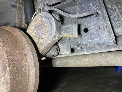

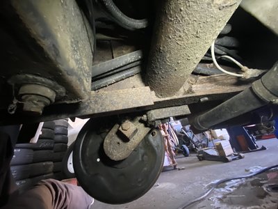

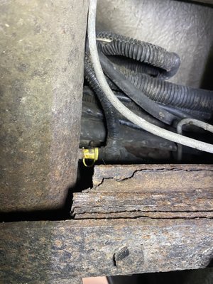

Interesting sought, no I have not. Vehicle is all original nothings been modified. Are holding tanks are empty. It’s a front wheel drive vehicle. Engine and chassis is designed by Ford. F350 series. One gentleman who owns one experience the same problem he thinks that there is a large rubber band or spring in the rear axle and overtime it wears out. Which reduces the drag on the rear tires. In the process of changing all four shocks and putting air shocks in to see if that fixes the problem. Have brought it to many RV dealerships and garages they are as confused as I am. The axle and brakes are a German design. The rear axle is not in line with the tires it’s someone offset more towards the front of the wheel. As if the wheels are on a rocker arm Of sorts. In the photo you will see a white tag That piece of metal should be pointing towards the ground when it was new. And I guess overtime that bar goes up. Which indicates that is no resistance in the axle. This is still one theory that I’ve heard. If you have any further thoughts or ideas please feel free to let me know. Once again thank you for your suggestion and thoughts. Appreciate it. James
Photo of left rear axle

I can see the argument that the bushings are bad. Ever been on a bike that developed a death wobble? I have, seems the bushings/bearings were in fact the problem. Torsion bars, neet.

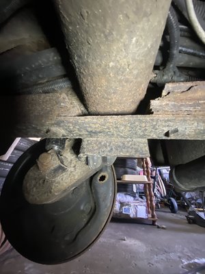

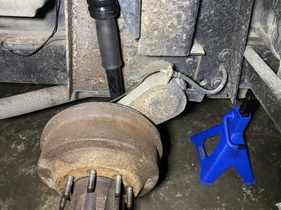

These are photos from obviously underneath showing the axle I noticed this afternoon that they were two caps which look like grease fittings on either side of the axle near the wheel. They’re very small maybe the size of an eraser on a pencil. I will definitely forward the information on the gentleman who is assisting me with the problem. I cannot thank you enough for your input on the situation. Also for some strange reason it looks like the old brake lines were removed. The wheels are free-flowing you can spend them in either direction with no resistance. But there are brake pads and calipers inside the wheel. Will take some more photos tomorrow. I’m a first time RV year and I’m amazed on how helpful the community is. It’s very heartwarming. Thank you again for your input and concern. Jameslove. Forever grateful.

Wondering if you ever diagnosed your problem. That is a torsion axle on there and they come in different angles, both downward and upward.

Nice Tom. Another point is that the rear axle pivots have a zerk fitting on each side front. This is not easy to get at and I wonder if non lube causes some internal bearing to give out. j
