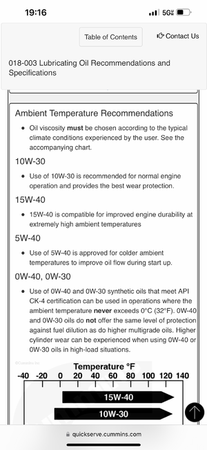

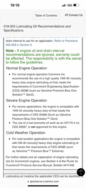

Folks, I have a 2021 superC with a cummins 6.7 diesel.
I buy an f250 every three years and put 130,000 into the last one, 155,000 on them
Many moons ago, working for an oil company, im an oil fanatic and changed my own even on the company vehicles.
So all I have is Moble1 for the cars and 15w40 T6 for the diesels.
So at 3000 miles on the Cummins, I dumped the stock crude that came in the Cummins and put 15w40 T6 in it.at 13,000 did it again two weeks ago.
Now I found out the 6.7 valve train was redesigned in 2020, and you must use 5w40, or the 15w40 will cause sludge build-up in the valve train.
Duh on my part, but going on an 1800-mile round trip next week and then will change to the correct grade.
Be aware!!!
