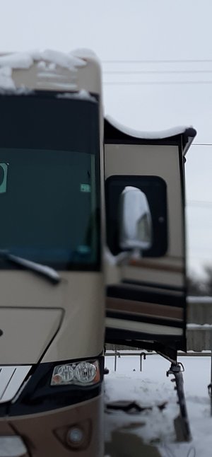

- Slide toppers do not work with snow. They don't roll up when a slide retracts, they fold up, they ice up, they are an epic disaster. Threads come out, they tear. You need to rethink this or even do away with slide toppers altogether.
