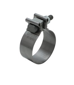

Over on that other forum there is a thread about adding a muffler to the Oasis piping. I just did that to help cut down on the noise. Here are a few pictures. I used a Jones Exhaust Turbo Tube Muffler ATT18S-3 and Vibrant Performance Exhaust Seal Clamps 1163. Now I just need a volunteer to camp really close to me to see how it works.

@Neal … thanks for the clarification on other site links. I wasn't sure if that was ok to do that or not. I did post my part list in posting #3 on this thread. Muffler was only about $22. The clamps were almost as much.

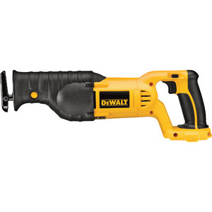

Did you just cut the pipe with a hacksaw?
I'll re-read that thread for parts and any tips on doing the job but if you want to outline any steps, parts, links, etc. here for others to learn from feel free.
