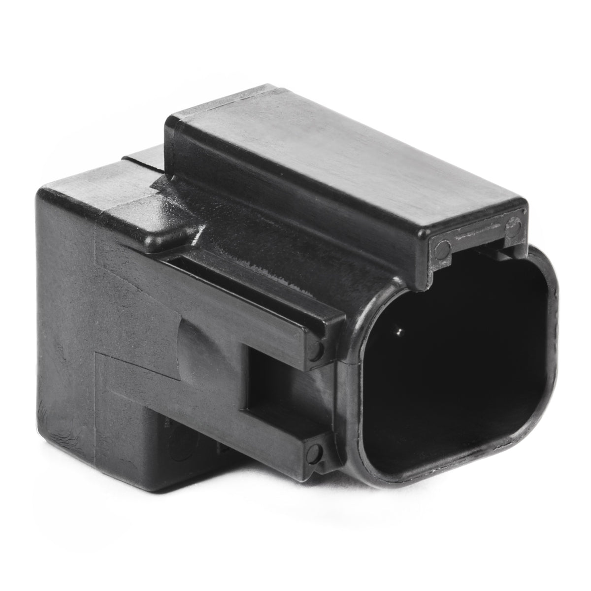

I was digging around in the fuse compartment (in the small basement storage area under the driver seat) and I found this guy with signs of having been very hot somewhere along the line. It appears to terminate a series of wires or to connect them together, but aside from that, I have no idea what the wires do or where they go.
2016 London Aire 4519
Anyone have any ideas?
I would try the directional signals or 4 way flashers and maybe high/low beam headlights to see if they work with that removed
DT04-4P-RT is a “molded in diode”. Don’t know what it goes to, but it shouldn’t over heat. Could be in the chassis lights system as @Chargerman suggested. Or….? Are you getting any DTCs?

Headlights are indeed compromised. Turn signals are operational, so are running lights, so at least I'm not dead in the water. Have an appointment with NIRVC in March, so I'll have this addressed at that time. Meanwhile I'll have to drive only during daylight hours.

They worked when I received the coach. That changed somewhere between Montgomery AL and Pensacola FL when I turned on the lights due to a massive rainstorm. While I was checking fuses for the heated seats I noticed an electrical smell in the bay under the drivers seat. This wasn't the condition of the diode when I left NC., or I would have noticed it.
So I don't know, it this part something that would self-destruct (similar to a fuse) in the case of on overheated wire? Maybe it did what it was supposed to do?

Diodes will last a very long time unless subjected to too much current - then they blow. If you want to do a little research, contact TE Connectivity:
As luck would have it, there is a Freightliner parts/service/sales 1 mile away. Found out this is not a Freightliner part, but they ordered it for me from one of their providers. $127.17 with overnight shipping! Oh well, had to have it, so it-is-what-it-is, right?
My concern is not so much what it cost, but what caused it to overheat in the first place. Hopefully it won't happen again, but we'll see.
Did any water get into that bay of the basement? You said it was a huge rainstorm...
