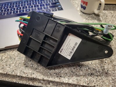

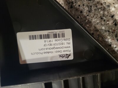

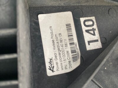

I have also had the controller die...which will also cause the steps to flake out. It is the plastic black block with wires hanging out of it. It is also under the steps.
