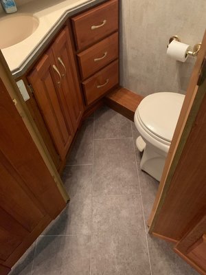

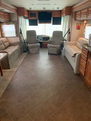

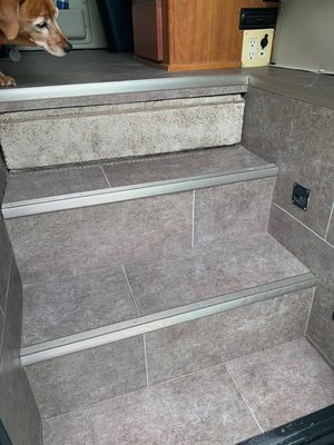

Luxury vinyl flooring that looks like tile may be a good alternative. It's warmer to the touch, softer to walk on, and will not crack and break as your chassis flexes when going over ruts and bumps at the CG. I wanted ceramic tile as well when we re-did all of our floors but RV Renovations and RV Service | Classic Coach Works told me they quit using the hard tile because there were too many complaints from their customers after it was installed. We went with the luxury vinyl flooring and couldn't be happier with it.
