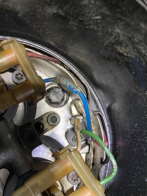

I meant RV not TV obviouslyThe issue is that the TV was stalling and then wouldn’t turn over at all. Batteries are fine. So mechanic says sounds like bad fuel pump. Also the wires on throttle body are frayed and I wonder whether that might be a problem View attachment 17516
Regarding the wires in throttle body—does that require replacement? I assume so. Entire unit or just wiring?Not the fuel pump! When a vehicle won't turn over (Unless it is turning over and just will not start two different things), it has nothing to do with the pump.
Those wires are not frayed they are fried.
