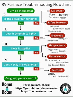

Our furnace has been working just fine. Last night I turned it off due to it being 70 degrees outside, when I turned it back on, it would make a click sound from the AC and wouldn't light or kick on or blow any heat out of the floor vents. We found where the furnace is but we can't seem to access the control board to check on it and other stuff unless one of us climb inside the under box and it's a tight space. Is there any other option other than this? I've read about making sure there's no obstructions and the only thing I had access too is where the fuel blows out on the front of our 5th wheel. This is so frustrating and it's going to be getting cold tonight and we only have an electric fireplace in the front livong area. Everything is going to freeze if we don't figure something out. Please help me. Thank you for reading!
Samantha
Hope you got it fixed.......the click from the roof AC is it knowing the heat was turned on and to turn on fan to distribute heat, and we assume you are plugged into shore power for that to actually happen. Will need more details to help - i.e. how long does the furnace fan run cold before shutting down, do you hear it click to light, does it light etc.
