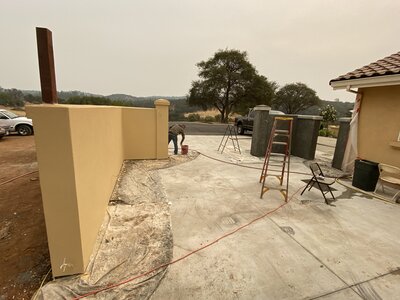

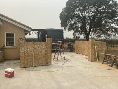

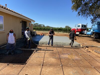

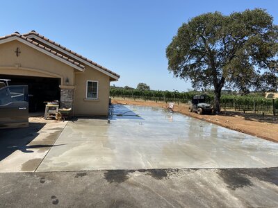

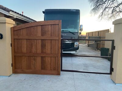

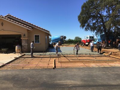

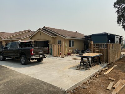

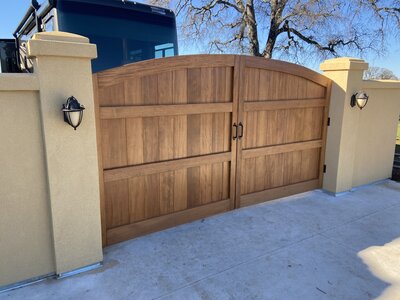

Heres few pics of our home RV storage I built last year with the help from a couple friends, and hired concrete finishers and stucco guys. The gate was my own creation with a steele frame, home designed and built hinges and $1200 worth of vertical grain fir. I added full hook-ups but also wanted it uncovered to take advantage of my RV solar which keeps everything running nicely. Still more to do but thats the nature of home improvement.
I made the gate opening 12’ wide which seemed like plenty at the time. But I lost a few inches with sheeting and stucco and at the outside edges of my mirrors Im 121” wide. So 12’ makes it a little tight. Should have gone 13-14’. Just something to think about. Also put in all the underground (elec conduit, water, sewer) you think you’ll need now. I put in a lot but missed one small section of electrical and now I get to cut a 3’ strip in the conctete under the side gate. Always lessoned learned doing this stuff.

Beautiful gate...very nice set up. When I saw the grapes I thought perhaps you were in our neck of the woods (Santa Barbara County)...but now-a-days there's grapes everywhere 😉 Looks like you did a 6 inch pour...nice pad. Blessings...

That looks great. Mine will be open but I really like your setup.

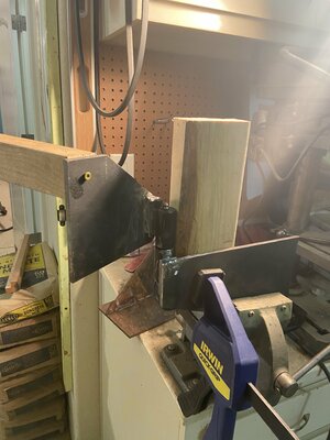

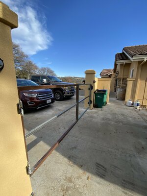

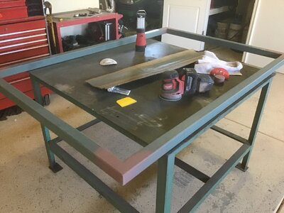

That gate spent more time on the drawing board that in construction. The hinges were the biggest challenge since there is nothing commercially available that would work. I had to design them to fit the application and fabricate them. The opening has 6x6 posts built in but I centered them on the opening side of 14” square pillars and should have held them to the inside or outside, so the hinges had to be longer on the bottom half. More lessons learned.

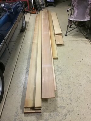

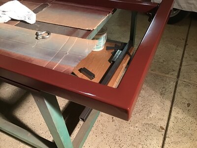

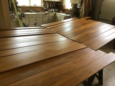

The woodworking part was just pure pleasure. I finished every surface before assembly to make sure it was all sealed well. Also building the frames was fun. Im not a welder (had to borrow one) but did some body work in my youth and went a little overboard on the finished product.
