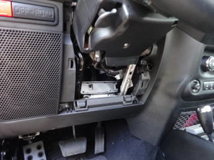

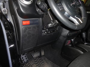

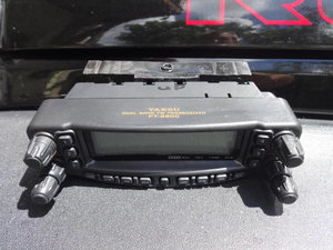

There’s a ton of space to mount a radio up under the dash; it’s just a bear to work up under there. But pulling off the vanity inspection plate under the steering column provides plenty of easy access and made a great place to mount a radio. (That's my radio in the first second picture with the faceplate removed.)
I ran power wires from the battery, through the firewall hole, and over to the radio. I like a direct power feed so I can operate the radio without the engine running. I suppose the opportunity for a drained battery is there but this is the same setup I have on my YJ and it hasn't bitten me yet.

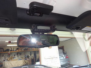

My radio is a Yaesu FT-8800 (Modified to opperate on GMRS and FRS) with a detachable face that can be mounted remotely. Having this option opens a world of places to mount the “controls” for the radio and I decided to install mine above the rearview mirror.
I fabbed up a metal brace and connected it to the detachable faceplate. Then with a couple of screws and some Velcro, I attached the faceplate just above the mirror.

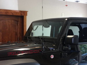

For an antenna, I used a Diamond K4005-NMO lip mount with a Larsen mobile 2m/70cm antenna which works great with GMRS or FRS.
It took me the better part of the day to put this all together, but all-in-all, I’m happy with the results.
