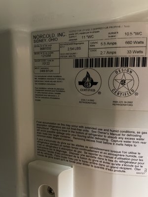

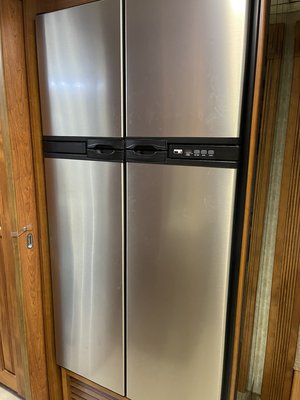

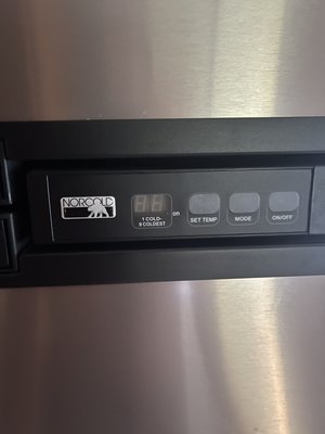

So im getting ready yo go and went to turn refrigerator on and light comes one for a min and goes all on LP AC and Auto what gives lol. Im sure its something dumb. I thought maybe because it was hot in rv so i ran ac but to no avail. Leaving Sunday an need to fix it
Here is fridge I have

So I checked outlets power no red lights. I ran out of light to check fuses plus the mosquitoes were having their way w me. I’ll check tomorrow in compartment. If I touch power button it lights for like 15-20 seconds an goes out. Very annoying maybe time go up grade fridge w reg one an run off inverter. Less to go wrong ?
