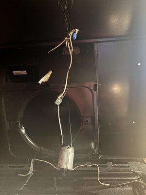

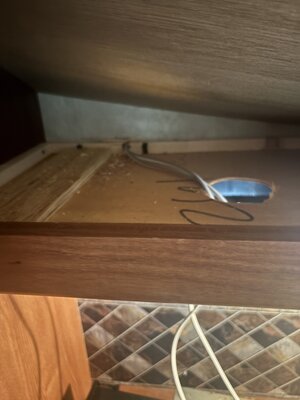

Thank you both, I’m going to post a pic of the wiring leading to the hood from above the hood and the wiring below. There is a sort of rubber shrink wrap around the wires connected to the motor but unfortunately there wasn’t a fuse under it. What I’m confused about is if there is no power running to hood then the inline fuse must be before the visible wires running to the hood, but wouldn’t the inline fuse need to be inside the hood in order for it to get hot enough to shut off?
