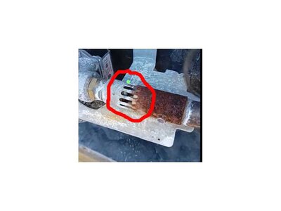

Sounds like too much air mixing with the propane. Try adjusting the gap on the tube. If the entire tube is rusted too badly, replace it.

That air setting has stayed the same for a long time. Most likely it did not change. Better to look at why the mixture has changed which leads you to check the propane and delivery system.
