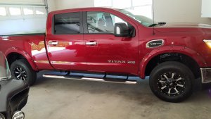

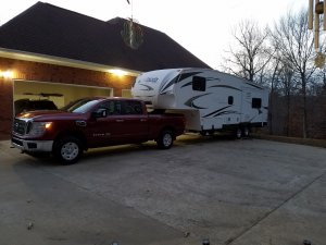

Another vehicle to consider is the Titan XD. I have one with the gas engine. It kind of falls between an F150-F250 or Chevy 1500-2500. It even comes standard with electric brakes and center bed hitch for a goose neck trailer. I have one "2017" and love it. I have the 7 speed transmission, but I think the newer ones are 10 speed.
It pulled my 5th will fine, but a bumper pull would probably tow better. With the same size trailer a 5th wheel is much heavier.
