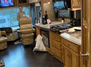

My Televator is right behind the fireplace in my coach. There is a cabinet to the left of the fireplace but Im guessing there is plenty of room in there to put a subwoofer if I can figure out how to get in there. The bottle of wine is sitting on top the the Televator. Sorry for the mess. It was our very first trip in the coach to set it up.

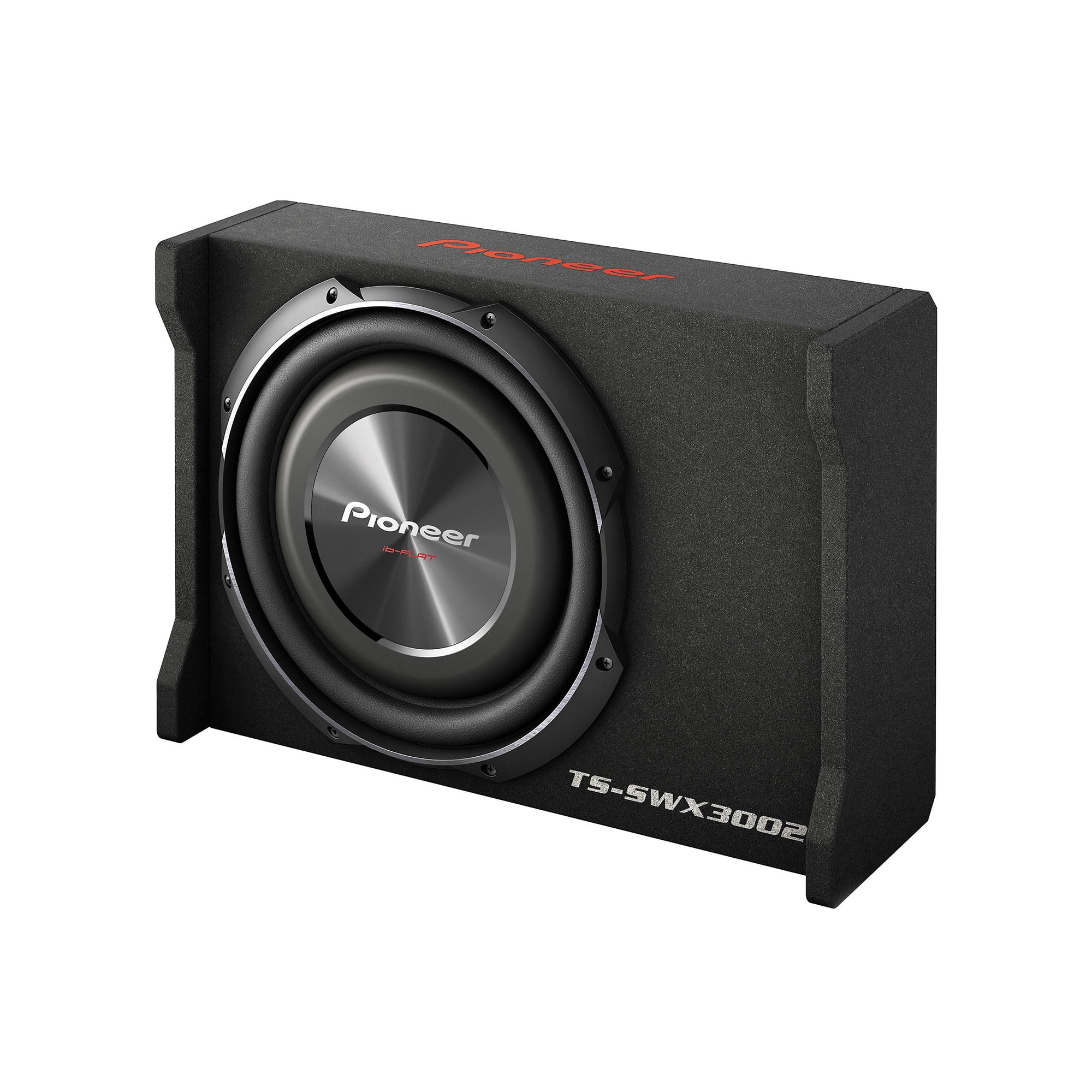

Subwoofers don't really make much noise other than thud. That location is just not good regardless. In looking at your photo above with the fireplace my thought is can you install a sub below the fireplace? Otherwise there really isn't a good location for one and don't forget you're doing to have to deal with getting the AV cable to it. My Newmar installed sub was not adjusted properly. If you can get to yours to remove it and adjust it you may salvage something out of it. You may want to consider a 10 or 12 inch Pioneer in that location and see what happens, and add an amp for it. I loved mine when I had it installed.
There is a 8, 10, and 12 inch version, I've had all three:

I think I found a hiding place for a new "slim" subwoofer. After removing the fireplace, there is an area just to the right that will work. It even has a power outlet to plug it into. I just have to be careful with the Televator.
Now all I have to do is figure out a way to get a RCA cable over to it.
You could wall hang it right and forward if it clears the fireplace and there is no heat concern. Can you get below the sub-floor of that area? If room below that it could be another option. The sub-woofer is likely going to use 12V and you'll probably pair an amp with it. And finally it probably has a 12V autosensing circuit for when the sub is on or off, not sure, been through too many in my experimenting thus far. I took the 12V off of the televator controller for the auto-sense. I think the 12V power I used was from the original sub in that was installed in my televator bay.
