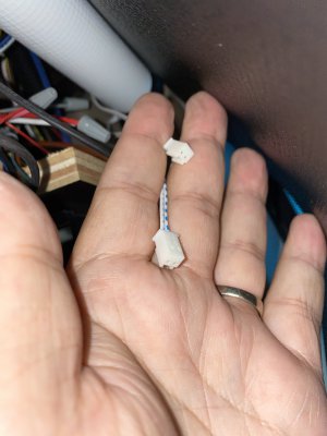

Thanks TJ. Good instructions. Just cannot find the reset switch. Looked for 2 days.
They can be hard to find, but are tucked up around the end of the shade roller. A flashlight may be needed to help you spot them.
OK...they are both two-wire pairs, right? Like miniature lamp cord? If so, just short the two wires in a given pair together. That's all a switch does.
I think I recall that a while back, Newmar just installed wires without switches. That may be the case with your coach. You could easily install a couple of miniature, momentary push-button switches on the two pairs if you want.
