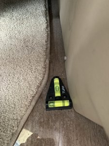

I mounted mine on the wall just behind the drivers seat where I can reach the switch to turn it on/off. It works fine at this location. However, I still tend to use this little guy most of the time. It really seems to be accurate. 6D0A8614-F9D3-4CFF-8CAC-C3D9FFDF1DE0.jpeg

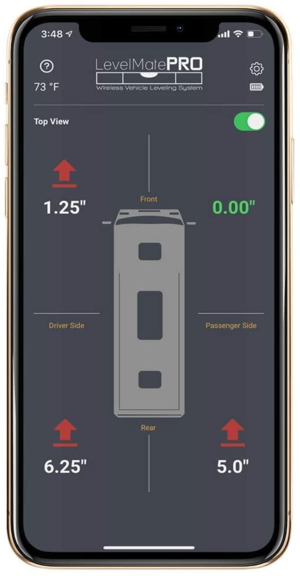

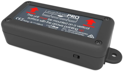

Plugging this device (LevelMate Pro) AGAIN as this is an invaluable tool I don't care what type of RV or leveling system you have. This thing is amazingly accurate and the smartphone presentation makes getting perfect level every time easy! I recently had to readjust my HWH Active Air leveling sensors and this thing was invaluable. For me leveling on jacks Equalizer gets close then I take over and level with this leveling system. It installs on the back wall of my overhead cabinet, so easy to use and so accurate. If you're OCD about "LEVEL" then I recommend adding this to your RV which is super easy. Again, it is extremely accurate and of use in any and every RV - it's that good!

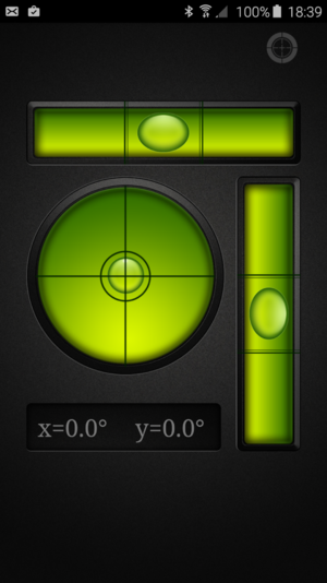

This is the "Bubble App" which I use on my Galaxy S-20.
Open the app, lay it on the floor, hit automatic level, & if needed use manual override.
It measures in degrees, the "yaw", right to left or front to rear. Very accurate!
I'm pretty "OCD" about leveling, but this little beauty is FREE!;)

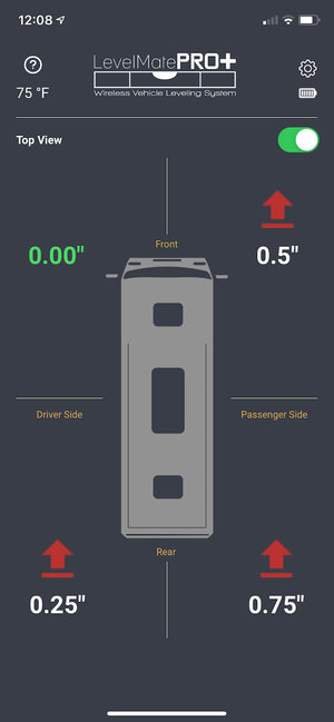

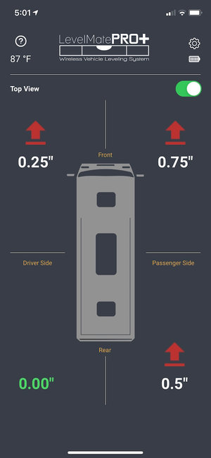

I bought one last year and it is good but not that accurate. I sent two of them back. From my testing with it, the reading will fluctuate depending on the temperature. When I spoke with the company I was told that each unit is tested at different temperatures and the error correction is written onto the unit. I was told this after I sent the first one back, so when I got the second one I started to take temperature reading and checking the display. I kept a log and sure enough (with a few exceptions) when the temperature varied from when the unit was calibrated to level it would show incorrect results and it was pretty consistent on what the temperature was and how far off it was. I sent the results to the company but they didn't seem to care, I told him I was just trying to help him make the product better but if he didn't want the help I'll stop wasting my time, after a long talk with the Company (I think owner) he offed to take LevelMate Pro back. I should have taken him up on it, I still have it, I play around with it but it is far from accurate and when I want to know if the coach is level I break out the 2' bubble level.
No problems with mine. I love it.
See how the level varies this is from yesterday and today. The coach has not been moved
