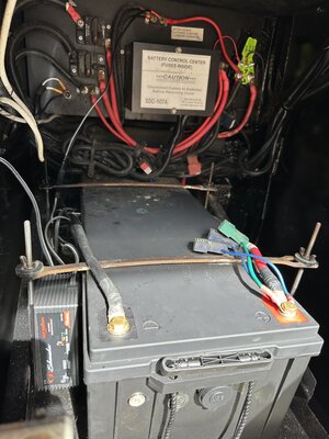

Several weeks prior to going to SES, we tripped a breaker in our storage unit and I did not know until I went to do a few things on the MH. Opened the garage door and something seemed off and noticed that there was no smiley bulldog on my watchdog. Went inside the coach and could not even get the KIB panel to turn on to see what my voltage was. Fortunately, I found the breaker box and found which breaker my unit was and turned it back on. But then I kept having bad thoughts of "next time". I had been contemplating this scenario and had been considering an RV whisper, so I ordered it and got it all hooked up. My primary purpose was to keep a remote eye on shore power and the chassis battery. (Yes, I can view the house side now with the Victron VRM).

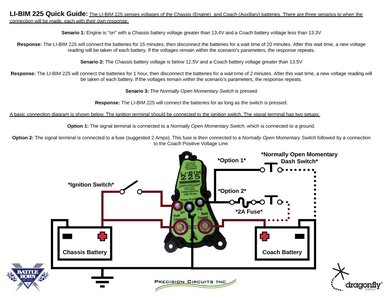

A few weeks of observing, my chassis battery would drain down to 12.5V and the standard BIM would connect and charge to 13.3 and release. This happened around 4 times a day. Not sure what the rapid drain was, but the standard BIM was keeping the battery charged. After the upgrade and the new Li-BIM, I am not seeing the same pattern. It now has a long slow drain.. We arrived home Tuesday evening, did a quick unload and put the coach in storage. That weekend we went down to go dump, clean bugs, and get the things that we forgot. I noticed that the chassis batteries were slowly ramping down, but they were still just slightly above 12.5V, so charging was not yet engaged. Not sure why they had a quick ramp down before and now it is slow. Over the next several days I continued to observe as the chassis batteries ramped down to 12.5 and down to 12.3 and the Li-BIM had not connected. All this time, the new Lithium house batteries had fully charged and had dropped to 13.5V and were cruising along in float mode. I asked SES and they sent the document below. There are 2 criteria that have to be achieved -- Chassis below 12.5V and house above 13.5V. Obviously the chassis batteries were below 12.5, but the house were rocking along at 13.5 - not enough to trigger connecting for charging as the house voltage has to be over 13.5V. I turned off the inverter charger for a few hours to drop the house batteries, hoping that when I turned them back on and they went to bulk or absorption, that would trigger charging the chassis. I achieved the result and the house batteries moved up to 14.2 for a couple of hours, but did not trigger charging the chassis. I did that again a couple of days later with the same result of no action. When I push the battery connect, the Li-BIM definitely connects, but I am wondering if it is otherwise defective as both conditions were met to connect and charge and it did not. SES claims that since it connects with the battery connect switch - that it cannot be defective, but I am not so sure.
I also started wondering how would the Li-BIM ever keep the chassis batteries charged. If the house batteries are content to go along at 13.5V in float mode, the condition that house the be over 13.5V will never be met. --- So wondering what those of you that have an Li-BIM have experienced?
