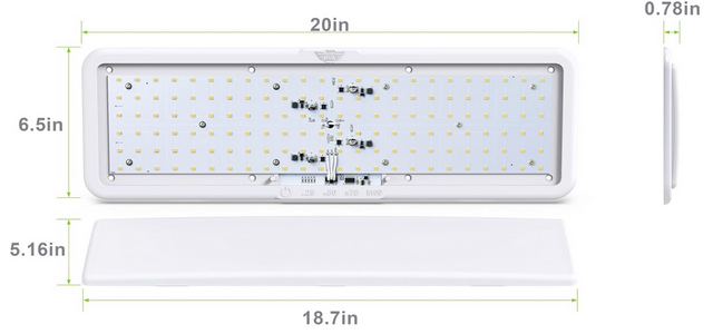

No specific issues with transmission but I want to have it serviced and fluid changed so I have a benchmark. It does however shift like yours between 1st to 2nd .... maybe that's normal? I did the LED headlight conversion but not the fog lights. My headlight assembly is Ford/Nissan. Knowing how RV mfrs slap things together, there's no guaranty yours are the same but I the part numbers at home. We changed all the interior pillow lights from bedroom to cockpit to integrated LED fixtures, they were a mix of original and replacement incandescents and some of the on/off switches were broken. Now they all look alike. One of the two large florescent ceiling fixtures didn't work so we replaced both with new integrated LED fixtures. They are the exact foot print but are less than 3/4" vs. almost the 2" thick originals. The basement light fixtures did not need to be changed so just replaced the incandescent bulbs with LEDs.

Yeah, I did the engine oil and trans fluid myself right after we got the coach. Someone else also said the shift was normal, so maybe it's okay, but in the back of my mind I keep thinking I should have done the trans filter too. Ford/Nissan? When you can, I would appreciate a part number? I can look it up and see if it's the same. And some pictures of your interior LED lamps please. The fluorescent tubes over the refrigerator went out so I put led tubes in the old fixtures. A huge difference, almost too bright, but please send me a picture of the thin replacements you found. And lastly I have done nothing with the basement fixtures yet. I was thinking LED strips. I have a case of them left over from another project, and they have built in magnetic reed switches so they would turn on when I open the doors. And from another thread - Good luck on the CW test. It's not too difficult. If I can pass it twice, you should have no problem at all. I have never used CW since then, but there's something nostalgic about preserving one of the first methods of radio communication. I think it would be fun to know it like the back of my hand, but making that first CW contact scares me to death.
The bus is in storage so I'll get photos when I can. In the mean-time, search this number B0D51J28DM on Amazon. These interior LED replacements are identical to the lights I installed (mine don't have a brand logo). They are also available direct from Alpha Leisure in Fontana CA. LED RV LED Ceiling Interior Light Fixture 1450 Lumen with Touch Dimmer Switch 12V 20 x 6" Natural White 4000-4500K With White Trim These are direct plug n play and work with the the two wall switches.
The replacement ceiling pillow fixtures look exactly like the originals only with integrated LEDs instead of incandescent bulbs. The wall sconce bulbs and under cabinet reading light bulbs over the sofa and in the bedroom can be replaced with LEDs as well. I'll need to look for that info. The bulbs in the basement pillow lights are 1156, the LED equivalents are cheap. I think I paid less than $3 each. Since changing them, I don't think I've ever turned them on!

No pictures necessary. What you have here is great. I already replaced all the incandescent interior lights with those same LED fixtures. Now I'm looking for something a little different. Maybe surface mount. Anyway, thanks for all the LED info. That rig is an ongoing project that will never be finished.
