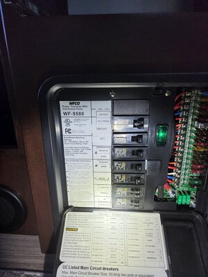

The Power supply system is shown in attached pic where everything above the Inverter/Main breaker is only supplied by the inverter
and everything below the Transfer/Main is supplied by only shore or generator power. (the power system with converter is the WFCO WF-9580 power center)
