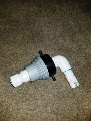

I guess you could, if you added a disconnect between the hose and the macerator. But I'm not sure why you would want to. The only part of the setup that is exposed to yuck, is the end that goes into the sewer hookup at the park. And that only has a small cap that goes over the hose where the yuck comes out. So all in all, one would be creating an unnecessary mess by disconnecting the hose in the first place.
I've left the business end of mine inserted into the park receptacle since I've been here. My daily process consists of pulling the black tank plunger and then pushing the macerator button. When the black is empty, I close it and pull the gray plunger. When empty, I turn off the macerator (push the button) and push the gray plunger back in.
It's such a clean setup that I'm not sure that plastic gloves are even necessary. When leaving camp, I put the plug on the business end and stow the hose in the bay. I really can't imaging disconnecting the macerator hose and stowing it somewhere else. Just not necessary and will cause more of a mess that if you leave it alone.
Edit: If having the business end loose in the bay bothers you, then put a plastic bag over it before you stow it. But I really don't think it's necessary.

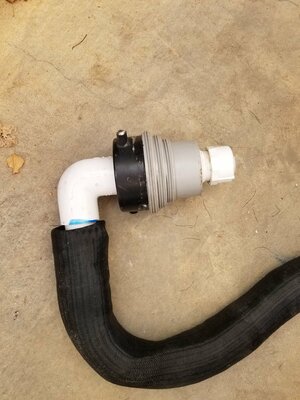

I also have a 2" mesh Protec hose covering our sanicon hose for protection. It's like a fire hose type covering. Amazon has it.

Is the Protec cover to keep from damaging the hose or to protect everyone nearby if the hose breaks while under pressure? I always feel a little antsy when I push that turbo pump button. :unsure:
It's to protect the fairly fragile hose, but probably offers some protection for onlookers.

Per above, I use it primarily for protecting the hose.
