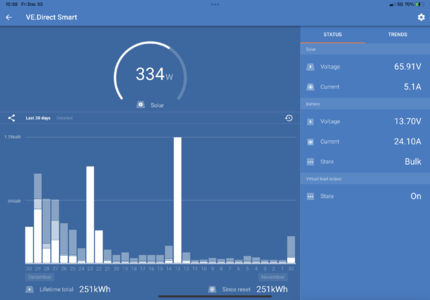

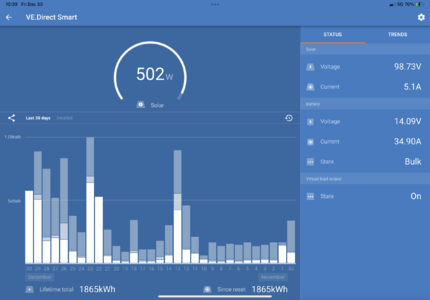

Since we are at our current location long term (only one month but a record in one place for us) we are on metered power for the first time. Since we have pretty good solar, I’m trying to maximize the “free” power and minimize the metered power.
So what I’ve concluded is that I should have shore power off as much as possible (obviously) and wait to turn on it on for laundry or whatever until I’m in Float on the batteries. That way I won’t be paying to charge the battery bank which is the biggest draw right now.
If I were in a climate where I needed/wanted AC, things would be different since this system won’t support an air conditioner, unlike previous versions. For heat (which I also don’t need here) I’d just use the Oasis, but the climate here this time of year requites no heat or AC.

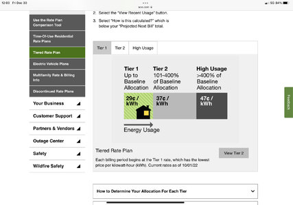

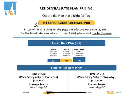

So that’s my strategy - seems to be working to keep that meter from spinning any more than necessary. I haven’t check to see what they charge here, but I’m guessing it isn’t cheap. What is a common long term park cost per kWh? What do you do?
Right now I’m still bulk charging from solar:
