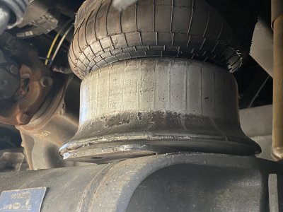

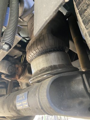

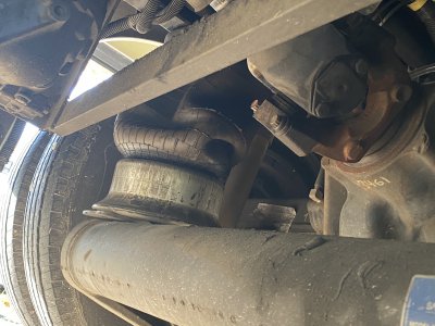

Need help. Air bags popped off rear.

In Mt Vernon KY. Looking for assistance.

Call Freightliner or use their app.
Just try airing up and if you need to also try high idle (cruise control ON and then press SET. Press cancel to come out of high idle).
Air bags do funky things, I've had one make a loud pop where I swore I blew one apart. They are just weird!
Thanks Neal. FL talked me through resetting the coach and fortunately for us the air bags reset on the pedestals. The bags blowing off the pedestals sounded like gun shots. The coach is now operating normally. Probable cause .... uneven terrain which caused an over extension of the jacks. Soooo much to learn.
Awesome job Neal. And good luck to you @skychs. That must have been scary.
Glad to hear. FL customer service always impresses.
