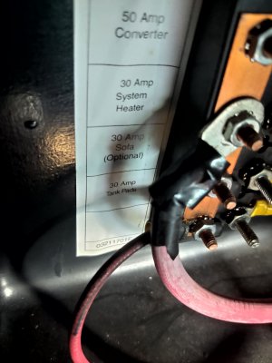

My Safari Simba was working with 50 amp service and inverting 50 amps using a renogy 3000 watt inverter or shore connection of 50 amp. Mechanic put in a 30 amp inverter (ms2012 Magna) and resticted the shore power to 30 amps. What do i need to get it back to 50 amp?

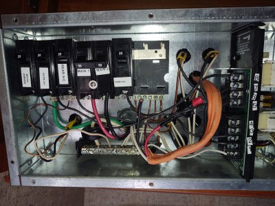

First of all, thanks for the thorough and clear explanation. The way it was wired to the main bus is the shore & generator power coming from the transfer switch goes into a 50 amp double pole breaker and has a 30 amp breaker (not shown in picture) feeding back to the 30 amp inverter on #10 wire, (2) 20 amp breakers for front and back A/C, hot water heater and vacuum in basement. At this point I'm wondering how the refrigerator, microwave and plugs throughout the unit are being supplied with power (no breakers feeding them from main bus)?We really need to know your wiring architecture. For example...my coach is 50A and uses a 30A input to the inverter (MS2812)
