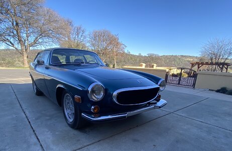

This is my only non-power steering vehicle at present and even being a small car, it’s nearly impossible to steer when stoped and would be abusive to try:

sweet car and showroom condition too..
