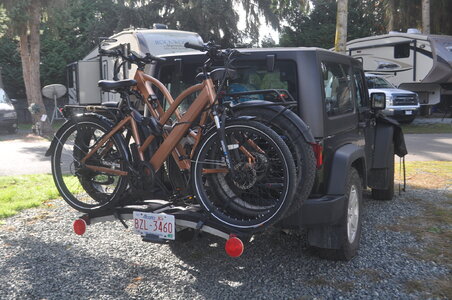

I did mine easy peasy. I got both from Curtis I believe. The towed system plugs into the left T/Light on the Jeep as does the trailer harness. I don't tow a trailer but I have a bicycle carrier that is "lit" because I have a cover for the bikes when traveling, thus it blocks out the Jeeps Tail Lights. Everything works fine towing the Jeep or just driving the Jeep with the carrier.
Pic of my lit bike carrier (did not come with the lights. I had to add my self).
