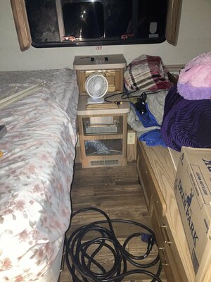

I have a 1991 fleetwood pacearrwo that I’m trying to remove the center nightstand out of. I took all the screws out but it’s stuck against the wall. I don’t want to damage my walls by prying it away. Am I missing screws behind the paneling or is there a easier way then prying it away?

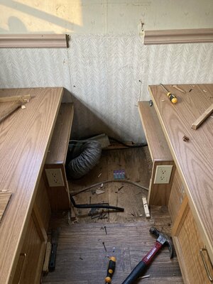

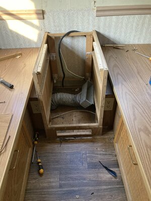

I did that and found out there are several screws from the outside of the home in. So I had to just demolish it, got it out though. Just need to remount the heating vent

Put a tab of glue on the ends of the screws that are coming through the wall. Now that they aren’t really tied into anything, they could easily work loose and damage the exterior. A dab of construction adhesive on the ends will help keep them from wanting to work themselves out.
