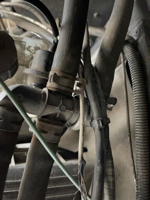

so it is a 460 gas . there are two line going into some sort of plastic thing then into 1 that goes to heater core . Lines are hot till it gets to that piece. I will take a picture of the part .Is this a gas or diesel RV? If it's a gas engine, You could also have an air lock in the heater core. Make sure the coolant level is full. Make sure the over flow tank is up to the fill line. Remove the radiator cap. Start the RV and get it up to full operating temp. Turn the heat on FULL BLAST. Rev the engine and hold it around 2000 RPM for a while. Then rev it up and let off a few times to see if the system will "BURP" the air out. If it does, this will probably be the problem. Once it does, top the system off, replace the Radiator cap and you're good to go! You should be able to feel good hot air coming out the vents when you're done. Good luck!!
let me ask you a quest some of the vac lines have been removed from stuff . should i just follow it back and see where it goes ? Im gonna start w tstat because regardless temp should be coming up. then ill trace line and see .Yeah, a thermostat is a no brainer. They are cheap. I'd replace that plastic deal too. Probably a valve that is stuck. If it's vacuum operated, check that the vacuum line isn't cracked or maybe came off the intake manifold? That may be why the valve isn't opening up.
Yay!!! Good job. You never know what you're going to get after the previous owner "fixes" something.So upon further inspection that little valve of the picture I posted has a zip tie holding it I guess open. So I’m going to need a new one but I was able to Jerry rig it and now it’s blowing heat. Thank you
