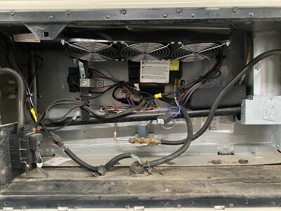

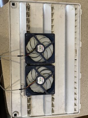

I noticed when we bought it that the fridge was not as cold as the home fridge. A thermometer showed about 45 degrees, just adequate. On our last trip, it was a little warmer and it was pretty hot outside. I pulled the side cover and the coils were extremely hot, so I decided to do the “fan” mod to move more air behind the unit. I also put an additional fan inside to move more air.
After doing that, I got 50 degrees on electric, 40-45 on gas.
