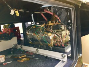

No tester required. Turn off the breakers, disconnect from shore power or trip breaker(s), make sure GEN AGS is OFF. Now remove the top panel where the 120V lines drop in and pull out the wires to inspect. Remove hour meter, inspect within there too. Remove front panel and inspect left side where the wires continue down and in.
Thanks. I have done all that in the past. Had the whole Oasis on my bench in the hangar. But leaving in the morning and want to have the tester just in case.

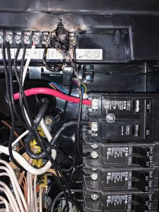

Today I gathered some desire to fix the Oasis electrical heater side. After checking everything around the unit, even replacing the AC relay, nothing changed.
Breaker panel was only thing left. Photo shows what I found. Another electrical “near fire” situation.
Now I need some drawing of how the wires are connected, since the labels are burned . If anyone knows, let me know.
Thanks
Looks like another inspection item annually on top of the transfer switch to ensure wires are secure.
That looks like more than a near fire, Buly. Holy cow!
I just realized that part with all the lugs is a removable shelf, which is a good thing. Now I have to find one.
Update.
Sent email with photo to Precision Circuits Inc (The manufacturer) to see if I can get the part from them .
