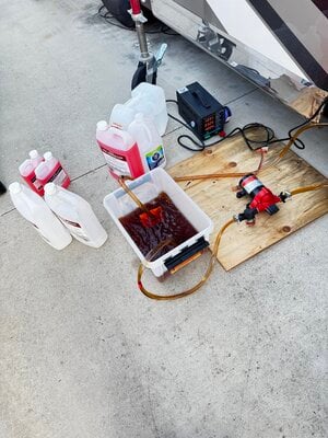

I done two so far. MY brother's and my system. It took me about 3 - 4 hours on mine and probably 3 hours on his. I use 10 gallons on my Ventana and 15 gallons on his Essex. It's not difficult but watching the video will really help. There are a couple fittings you will need to connect tubing to the Oasis drain and fill connections. (3/4” GHT to 1/2” NPT fitting )
The AZ Expert offers a comprehensive video showing the procedure to drain and refill your Oasis hydronic heat system on YouTube. I plan to complete that procedure in the spring!
Thanks. I have watched that video….and it helps, but I have an Oasis NE-S which does not have the separate junction box…. I have instructions that show that you should flush with fresh water which he didn’t not do.
So do many people do this themselves? I am leaning that way….
Did it in November - bought a pump and basically it was 3-4 hours. Watch the video from the guy in Arizona.
I bought a 25' piece of clear hose and cut in half and a few fittings - enough hose to reach outside the bays easily.
the boiler fluid is most of the cost.
Made a little flat tray to go under the fittings with a piece of sheet alum and bent up the edges and sealed the corners with silicone to avoid too much drip. Not sure it was worth it, a sheet of thick aluminum foil and some rags would have worked the same. remember to follow directions to get air bubbles out. Also clamp the hose at the oasis that goes to the overflow or you cannot open the radiator cap on the oasis without leak (ask how I learned that...)

I appreciate everyone’s feedback and comments. I think I am going to give it a try in the coming weeks. Mine might be easier as my pumps and drain are right up front. (There is no separate box for the pumps) Although the NE-S does not have a radiator cap to siphon out.
I updated my post above with a better pic of my NE-s behind the front panel. At least I don’t have to crawl into the rig to do this. :)
I also attached the instructions that I received from ITR for my unit….so although it may not work for many of you, it should work for the NE-S.
Now to buy 15 gallons of fluid and find the time!
Will keep everyone posted on how it goes and lessons learned.

Phase one complete,
:) Camping world had it on sale for only $20,99 per gallon.
