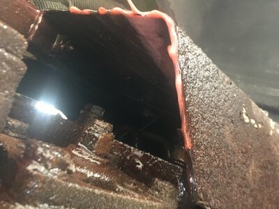

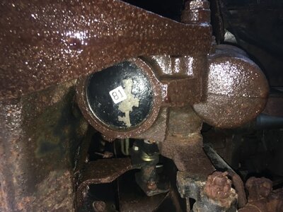

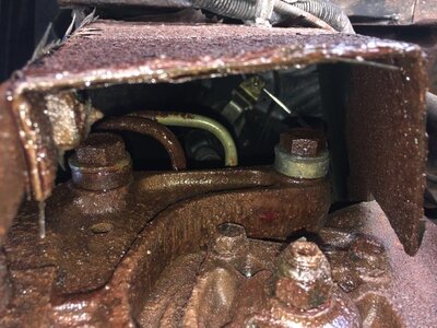

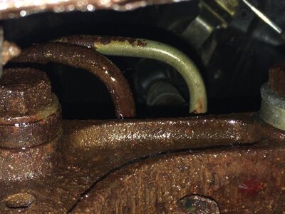

To make matters worse I had to be towed back to where we are staying, even though I had requested a flat bed tow I got a wrecker and the drive shaft needed to be taken out, but the wrecker didn’t put it back due to policy and now I’m stuck having to do that myself with very little experience. Add to the frustration I have to do bucket runs to get rid of holding tanks water and we have to be out of here in less than 2 weeks. So I’dont have the luxury of time to wait to be towed to a shop and have to wait longer than I could do it myself or find a mechanic to come out to work on it I’m attaching a photo in the hopes that someone can identify this one part as the leak seems to be coming from somewhere above that area but I can’t access it even with the doghouse off. The most likely culprits are a bad main line, bad PS pump or bad seals in the Hydrobooster which I’ve read there are rebuild kits but mixed opinions about them Sorry if this was long and winded. Thanks
