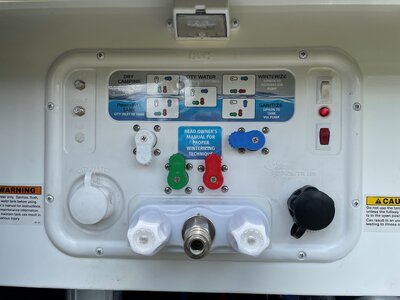

We have a 2019 Precept 31 UL. We were hooked up to city water for the last four days. Fresh water tank was empty. Prior to leaving this morning, I switched over to fill the fresh tank. I then switched the valves to Dry Camping and turned on the pump. Pump runs fine but no water coming from any of the faucets. We had no problems using water from the fresh tank in the past. I suspect we have a valve problem. See pic of the face plate. I had a look behind the face plate and it does not look user friendly back there. Does any one know which one of the valves is faulty? There should only be a choice of three as the Red only moves for winterizing. I am guessing it could be the green but, I would rather not guess. Any advice?
Thanks

You may have an airlock. Try opening all the valves and the low point tank drain valve. Try various combinations then only one valve open. You may also try, with the pump running, cracking the discharge on the pump ( you may get a bath).
Thanks for the tips. We are hooked to city water now but I ran through the gamut of your suggestions first. No luck but, once tied to city water the pump actually charged the system so definitely not an airlock. I'm pretty sure I have it nailed down to the green valve now though. It looks to be easy to change from the front of the panel but I cant get at it without disconnecting a whole lot of other piping so I'm going to leave it for the pros. I have an appointment booked at the dealer on the 3rd of July.
