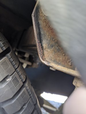

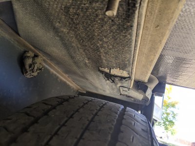

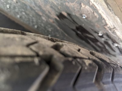

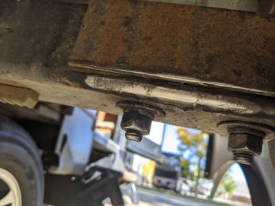

NHTSA 11363266: 2016 Primetime Crusader slide bracket cutting groove in tire.
The right side rear tire rubs on the slide out flooring and the slide out cross member (including mounting bolts/nuts) and slide out end bracket.
The unit was manufactured with insufficient clearance to prevent tire rubbing. The tire rubbing has caused damage to tires and is destined to instigate catastrophic tire failure while going down the highway.
The clearances are insufficient to prevent contact when he suspension is compressed from normal highway bumps.
I have pictures attached that clearly show three contact points where the tire has rubbed the finish 1- off of the steel members, 2-physically wearing away the nuts and bolts, and 3-is wearing a hole in the slide out flooring in multiple wheel locations.
The end bracket cut a groove in a tire and was luckily noticed prior to catastrophic failure on the highway. It was deemed not repairable by discount tire and thusly replaced.
After installing the OEM spare tire I applied some touch up paint to the rubbing locations we completed one short trip. The paint was once again rubbed off as it makes contact with the tire. This design needs to be recognized as a safety issue and rectified by the manufacturer. I suspect it has caused numerous catastrophic tire failures and initially blamed on the tire manufacturers. OEM tires are towmax power king. I replaced with Goodyear endurance.
Primetime had an identical issue in a 2014 315 model with identical wear points. An NHTSA recall was ordered with a lift kit to be installed that remedied the clearance issues. 2014 prime time 315 NHTSA 14v-140. A recall was ordered and a lift kit installed.
I have contacted the manufacturer in good faith. They say it is outside of the manufacturers 12 month warranty period.
I do not believe a safety issue is excluded from the manufacturers responsibility.
I recommend you check your Primetime crusader for identical rubbing issues. Please reply or contact me with a private message.

Only three things that come to mind on this.
1). The tires installed are too tall. Maybe someone replaced them with a larger diameter tire. There should be a sticker somewhere that show what tires size it should have.
2.) The trailer springs are "relaxed". The springs have become weak.
3.) the trailer/tow vehicle are not level when towing.

I've since discussed with a few folks. They suggested the trailer should have 3" minimum or 4" better of clearance. From my pictures you can see I am about 2", maybe less. Both said this is becoming a routine issue with some brands. They are seeing increase design problem issues. Both have recommend a lift is needed.
When the spring compression is at or more than the clearance this is the outcome.

For those with the Crusader models I would suggest you take a peak behind the fender well and look for anything that is rubbing. It's pretty easy to see. Look for shiny polished edges that removed the black paint. Look at the floor immediately above the tires. It has a black plastic covering and will be shredded if you are making contact. If you are seeing any sign of contact your tires are susceptible to the catastrophic failure that was only covered under the prior recall. If the tire blows you will probably have more extensive damage to you unit.
